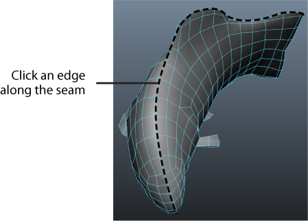

- Select an edge on the seam of the model.
Important: Select a seam edge that is not included in your edits. Modifying any of the seam edges disables symmetry.
