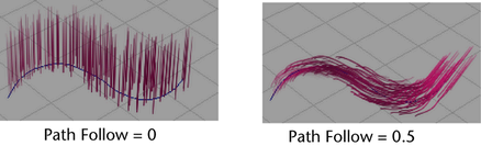

- Path Follow
Defines the magnitude of the force that attempts to make tubes grow in the same direction as their corresponding points on the stroke path. If the value is 0, no force is applied to the tubes. As the value increases, the tubes follow the path more closely. A positive value follows the stroke path (like combing the tubes in the direction of the stroke path) while a negative value follows the reverse stroke path (like combing the tubes against the direction of the stroke path).

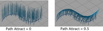

- Path Attract
Defines the magnitude of the force that attracts tubes to the stroke path at each step of the growth simulation. If the value is 0, no force is applied to the tubes. As the value increases, the tubes converge onto the path. A positive value attracts tubes while a negative value repels them.

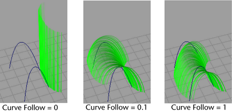

- Curve Follow
You can make tubes follow control curves that are associated with strokes. For details, see Modify tube behavior using control curves. The CurveFollow setting defines the magnitude of the force that tries to make tubes grow in the same direction as the associated control curves. A positive value attracts tubes while a negative value repels them.

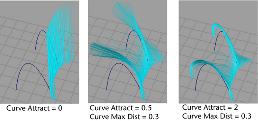

- Curve Attract
You can make tubes attract to control curves that are associated with strokes. For details, see Modify tube behavior using control curves. The CurveAttract setting defines the magnitude of the force that attracts tubes to the associated control curves. A positive value attracts tubes, while a negative value repels them.
- Curve Max Dist
This setting has an effect only if Curve Attract or Curve Follow is on. It defines the maximum distance (in world units) from which a curve can exert a force on a tube. If Curve Max Dist is set to 0, there is no maximum.

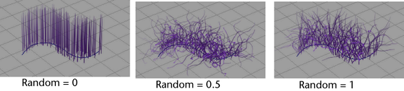

- Random
Defines the magnitude of a force with a random direction and intensity, applied in the local space of each tube. If the value is 0, no force is applied. As the value increases, the force increases. This value is useful for making trees and bushes appear gnarly.

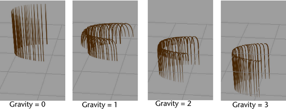

- Gravity
Defines the magnitude of a downward force (relative to the up axis). If the value is 0, no gravity is applied.

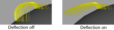

- Deflection
Turn on Deflection to apply a force that stops tubes from passing through the surface or plane they are growing from (for example, when gravity pulls branches down). The force pushes upwards and is stronger closer to the surface or plane.
Note: Deflection uses an approximation of the surface to do the deflection (a plane), so deflection will work best for short tubes or relatively flat surfaces. To deflect longer tubes, use control curves with negative Curve Attract settings (see above).

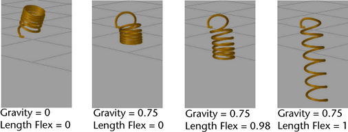

- Length Flex
Defines how much tube segments can stretch in response to forces. If the value is 0, no stretching occurs. If the value is 1, tubes stretch just as far as required to match the force.
