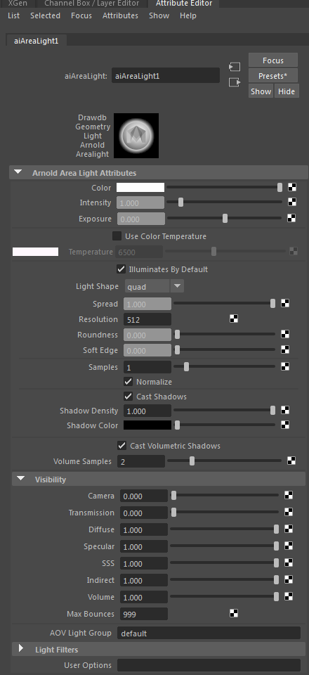

Area Light
There are two ways to use an Arnold area light in MtoA. You can either add a regular Maya Area Light, in which case Arnold will assume a rectangle/quad source or if you require a different shape, you can alter the light node type to be an Ai Area Light. Note that Arnold will render assuming that the area light is a quad. If you need a different shape, you will need to select Ai Area Light as the node type instead. The Ai Area Light is a custom Arnold light that enables the user to create realistic lighting effects based on different preset shapes such as quad (default), disk, and cylinder. The most important attribute of the Arnold Area Light is 'Light Shape'. This specifies whether the area light is the default quad (rectangular) shape, cylinder shape, or a disk shape. This is the first attribute you should set - choose the one which matches the geometry to which you are attaching the light.
Note that if you just use a regular Maya Area Light instead of the Arnold Ai Area Light, you will have all the control attributes under the Arnold tab that you would for an Ai Area Light if you selected the quad shape (apart from the 'Light Shape' attribute).
Quad
Simulates light from an area source (a quadrilateral, specified by four vertices). It can be used to model light from an extended source (fluorescent strip lights) or in some circumstances from a window.
Cylinder
The cylinder light shape simulates light from a cylindrical area source (tube shape). Increasing the size of the cylinder light will create a larger area light size and therefore will soften the shadows that run perpendicular to the cylinder's axis. Cylinder lights will always be circular. It is not possible to scale the width to create an ellipse.
Disk
The disk light shape simulates light from a circular area source (flat disk).

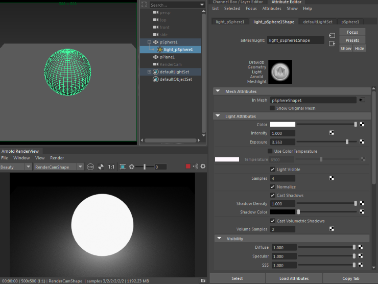

Mesh Light
To create a mesh light, select a mesh and go to Arnold->Light->Mesh light. A separate node is created to represent the mesh light source which references the shape node and has the same attributes as a regular light. It should be visible in Maya windows, such as the Light Editor, Light-linking Editor, etc.
An example mesh_light scene can be found here.
The current limitations when using a mesh_light are:
- Mesh Light ignores smoothing on poly objects.
- NURBS surfaces do not currently work with mesh_light.
Changing the mesh parameter "translator" to "mesh_light" is still supported, however, it is now considered deprecated and will be removed in the long-term future.
Mesh Attributes
In Mesh
Displays the name of the shape used as a mesh_light.
Show Original Mesh
Displays and renders the original mesh shape chosen to represent the mesh_light.
Light Visible
Makes the light source visible to the camera.
