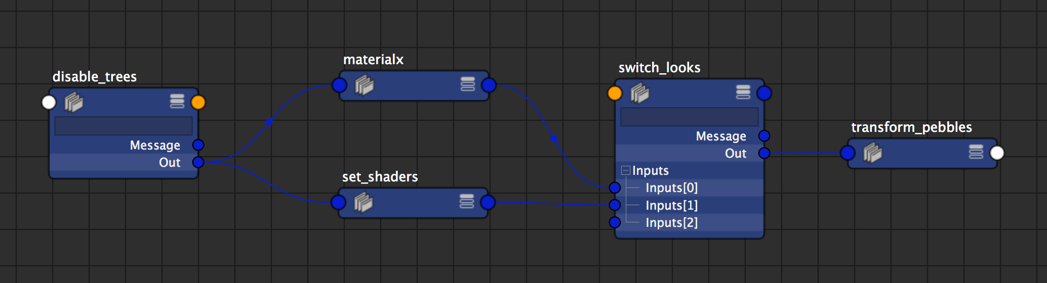

Operator graph in the Node Editor
Operators allow advanced users to override any part of an Arnold scene and modify the Arnold universe at render time. Probably one of the most common use cases is to override parameters (e.g. shaders) inside a procedural (e.g. ASS or Alembic). To achieve this you must know the Arnold node and parameter names defined inside the procedural.

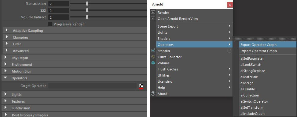

Operators can be created in the Render Settings, the Arnold menu, or in the Node Editor window

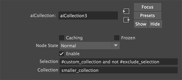

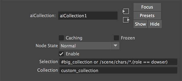

Figure 1: Create a custom collection from a larger collection
Figure 2: Define a collection of trees that should be excluded
Figure 3: Create a smaller collection using the exclusion collection in Figure 2

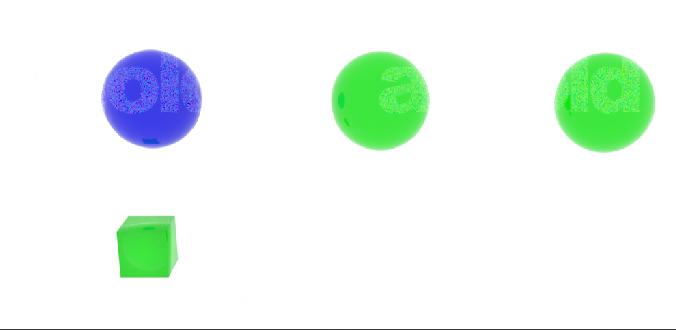

set_parameter used to assign shader 'green' from a stand-in to objects in the scene

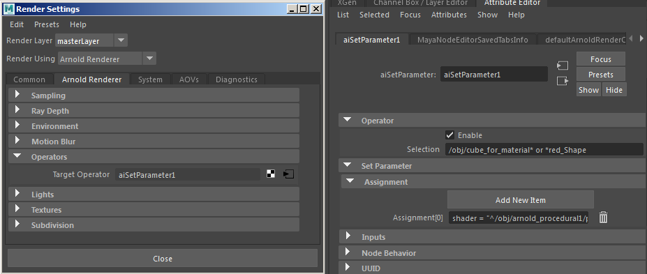

In this example, we want to assign a shader used inside a Procedural (Stand-in Maya/C4D) to objects in the scene. In the Procedural, there is a shader called 'green' that works for overrides on objects inside the ass file since this green shader is in the same Procedural. The full path for the shader is used inside the Procedural for it to work for both the shapes in the ass file and the ones coming from the scene:
shader = "^/obj/arnold_procedural1/procedural^green"
You could choose a namespace for the Procedural by setting the namespace parameter on the Arnold Procedural object node in the Arnold parameters (to foo for example). Then you can use the following shader override which is more intuitive and has the same effect.
shader = "^foo^green"
Green shader from Procedural assigned to the cube in the scene

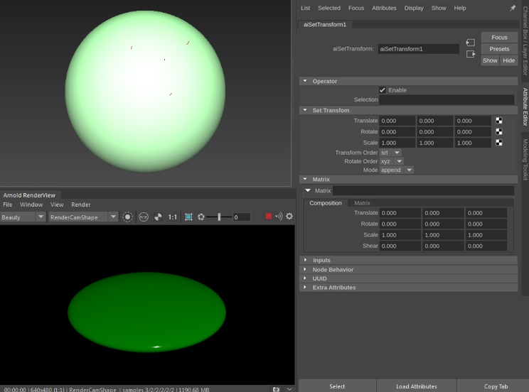

Scale adjusted using set_transform
The above example scene file can be downloaded here.
