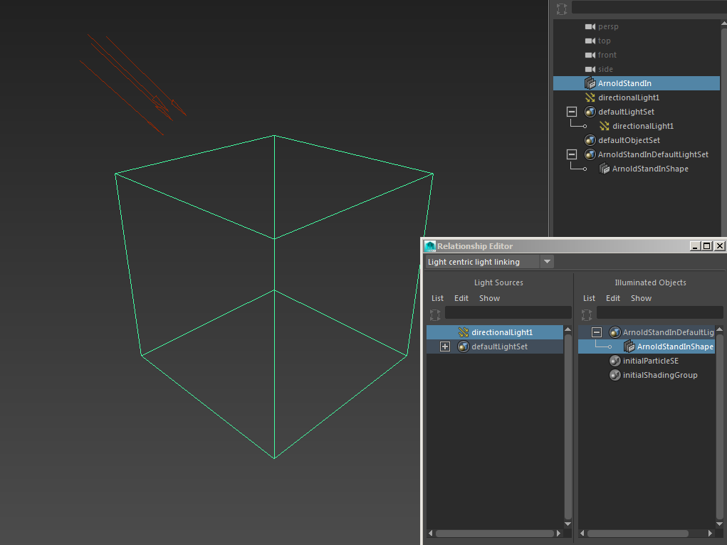

Custom Arnold lights don't appear in light Linking Window
Currently, Arnold custom lights like skydome and area will not appear in the light linking window.
A workaround is to use the defaultLightSet to change light linking options for Arnold lights (make sure to refresh the IPR when making changes in the light linking window).
- A video demonstrating this process can be found here.
Arnold Standins in the light linking window

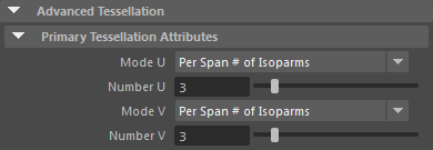

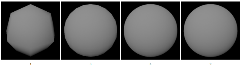

NURBS tesselation
MtoA relies on Maya to tesselate the NURBS before sending it to Arnold as a polymesh. MtoA does not support simple 'Simple Tesselation Options', however, it does support the 'Primary Tesselation Attributes' under 'Advanced Tesselation' (see images below):
Per Span # of Isoparms - UV
(1,3,6,9)

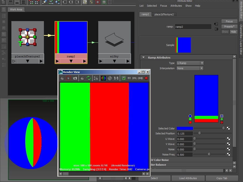

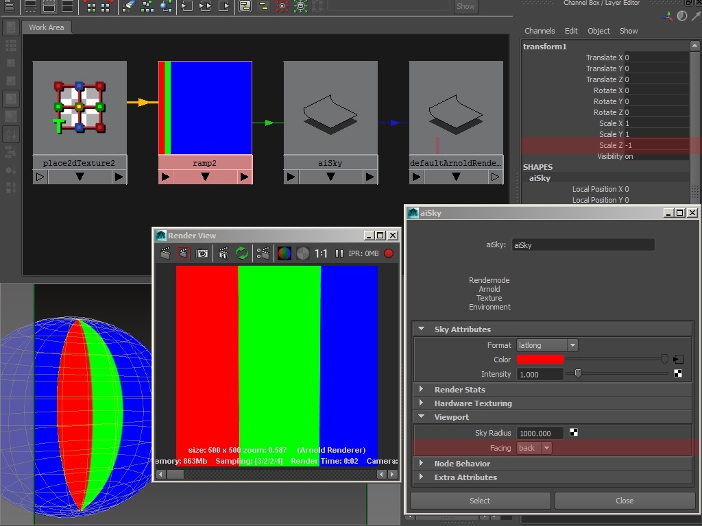

Ai Sky UV mapping is reversed
A ramp texture that is set to the U direction will render incorrectly when connected to the sky shader. This can be corrected by scaling the sky shader -1 in Z and setting facing to back.
U ramp renders incorrectly.
Scaling the Sky -1 in Z and setting facing to back fixes the problem.

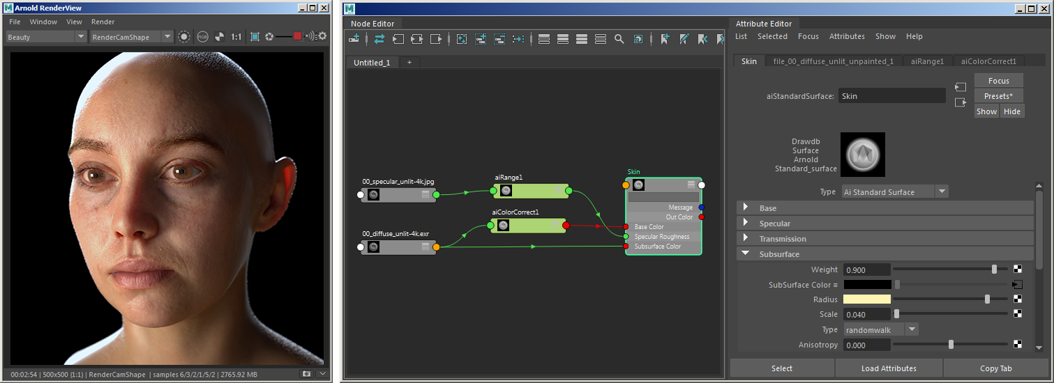

How to render skin
The following shading setup can be used to recreate a skin material.

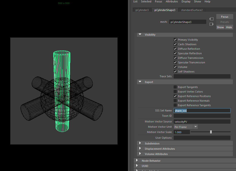

How to use sss_setname
The following example shows how to share sss between objects.
Same sss_setname used for all objects that require sss between them

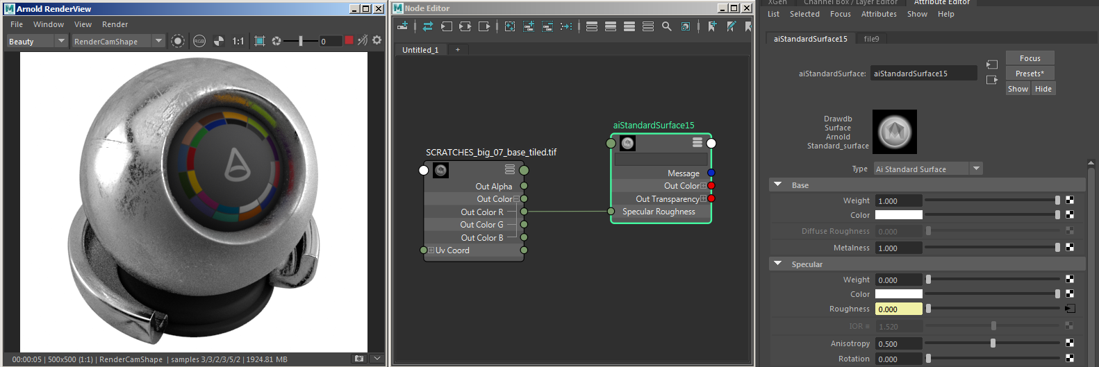

How to connect a texture to specular_roughness
The following setup shows how to connect a texture map to the specular_roughness.
Out Color R of file texture -> standard_surface.specular_roughness
