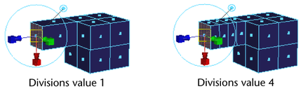

- Divisions
Controls number of sections along the length of the extrusion.

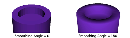

- Smoothing angle (Faces and edges)
Specifies whether the edges of the extruded geometry are soft or hard. If you want the extruded edges to appear soft, set the Smoothing angle to a high value (for example, 180). If you want the extruded edges to appear hard, set the Smoothing angle to a low value (for example, 0). The default smoothing angle for extruded faces and edges is 30.

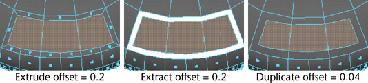

- Offset (Faces and Edges)
Enter a value to offset the edges of the extruded faces. Offsets for extracting and duplicating faces are also shown here for comparison.
This option can be used to produce a bevel effect for extrusions, cut-outs around faces using Extract, and to uniformly scale duplicated faces.

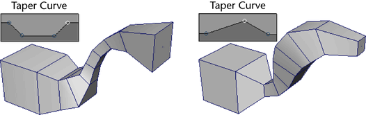

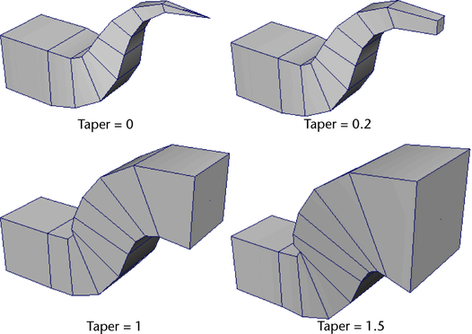

- Taper (Faces and edges)
Scales the extruded polygons as they travel along the curve. Twist is only available when extruding along a curve.
To control the taper exactly, open the Taper Curve section in the Attribute Editor and use the graph control to set scaling along the length of the curve.

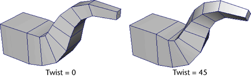

- Twist (Faces and edges)
Rotates the extruded polygons as they travel along the curve. Twist is only available when extruding along a curve.
