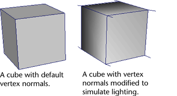

Normals have a direct effect on the appearance of shaded polygons.
The normal values you specify (or if you use the default values) are fixed for each normal associated with the vertex or vertex/face component. This means that if you change a vertex position, normals do not change position.

Lets you adjust the user-defined normal of a vertex (or several selected vertices) using a manipulator. For example, you can make sharp edges appear smoother or adjust the lighting on a polygonal object by modifying the direction of the vertex normal.
Editing the vertex normal with this tool overrides the existing Maya normals for the mesh and locks the user-defined normal you set. You can unlock the user-defined normal using Mesh Display > Unlock Normals.
Note: Editing normals with face/vertex components can cause new hard edges, any unlocked neighboring normals might move in the process. Lock any neighboring normals you want to remain unaffected prior to editing.Select Mesh Display > Vertex Normal Edit Tool >
