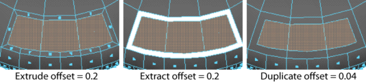

- Offset
- Enter a value to offset the edges of the extracted faces. Offsets for extruding and duplicating faces are also shown here for comparison. This option can be used to produce a bevel effect for extrusions, cut-outs around faces using
Extract, and to uniformly scale duplicated faces.
