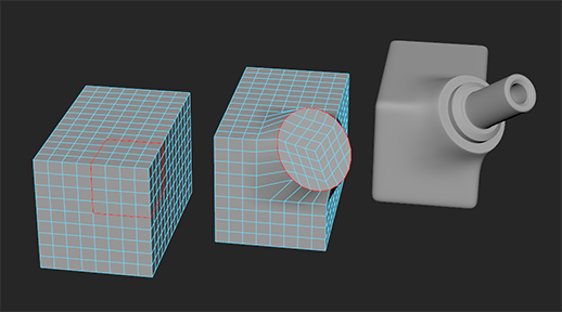

Collapse
Collapses edges on a component by component basis and then merges the associated vertices for each collapsed edge separately. Collapse also works on faces, but produces results that are more predictable when using edges. If you wish to collapse and merge a selection of faces you should first select Edit Mesh > Merge to Center.
Connect
When vertices and/or edges are selected, Connect connects them via edges. Vertices are connected directly to connecting edges, while edges are connected at their midpoint.

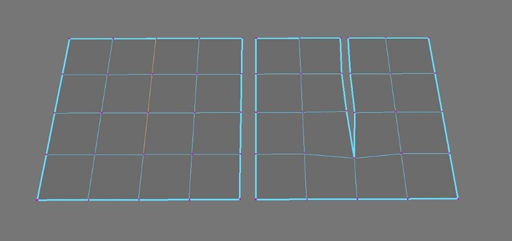

Detach
When vertices are selected, Detach separates any selected vertex that is shared by multiple faces into multiple vertices depending on the number of faces the vertex shares. The edges of the faces associated with the vertex also become unshared as a result. When faces are selected, Detach separates the face selection along its perimeter edges. When edges are selected, Detach separates the selected edges into two overlapping edges. If you perform a Detach operation over a path of edges, the vertices along that path are also separated along that path. The vertices at the ends of each selection remain attached to both of the new edges or edge paths. If both vertices and edges are selected, Detach defaults to the same behavior as when only vertices are selected.
Note: Detach ignores any vertices that are not shared.
