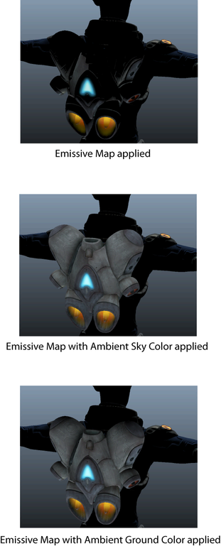

Ambient and Emissive
- Emissive Map
- Enable this option and connect a file texture to Emissive Map to apply an emissive texture that is bright like a light source. To stop using the texture, disable Emissive Map.
- Emissive Intensity
- Use this attribute to control the amount that the emissive map contributes to the shader.
- Ambient Sky Color / Ambient Ground Color
- Use these options to brighten the object by simulating light coming from the ground or sky.
- Ambient Occlusion Map
- Select this option to add ambient occlusion to your scene. Connect a pre-baked map that affects only ambient light in the shader.

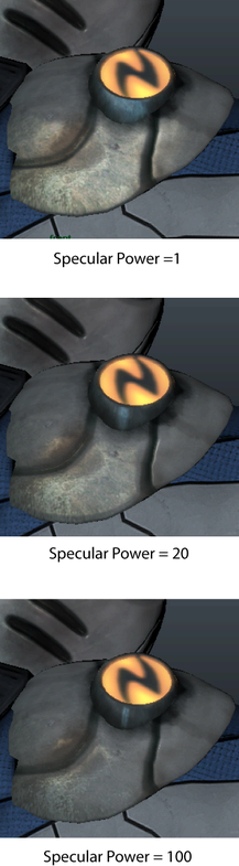

- Specular Power
- Specular Power controls the shape of the specular highlight.

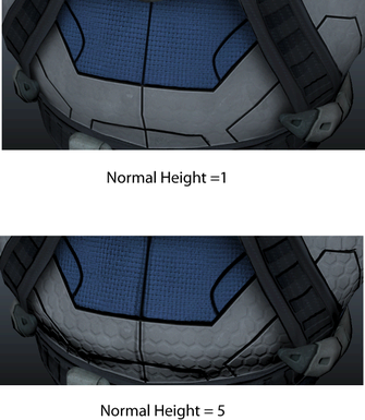

- Normal Height
- Use the
Normal Height option to change the height of the bumps in the normal map texture.

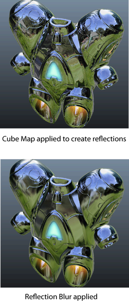

Reflection
- Reflection Map
- Select this option to use a reflection map in your scene.
- Reflection Type
- You can connect a .dds cube map or a 2D spherical or latlong map; or, a combination of a cube map and a 2D map. Select from the drop-down list the type of map(s) you are using.
- Reflection Cube Map
Select the Reflection Cube Map option to include reflection in your scene. A Reflection Cube Map allows you to create more realistic pre-baked reflections. Use this option to connect a .dds cube map.
Tip: You can generate cube maps using freely available third party tools. - Reflection 2D Map
- Select this option to connect a 2D spherical or latlong map.
Tip: IBL and reflection maps should be in the same color space as your other input textures. When using the Linear Space Lighting setting in the AutodeskUberShader, input textures are expected to be in sRGB display space; therefore, IBL and reflection maps that are not in sRGB color space should be converted into this space through image editing software.

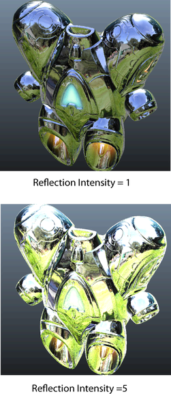

- Reflection Intensity
- Use this slider to adjust the intensity of the reflection on your object.
- Reflection Blur
- Use this option to create a blurred reflection effect. This option gives you more control over the type of metal or material you are trying to simulate.

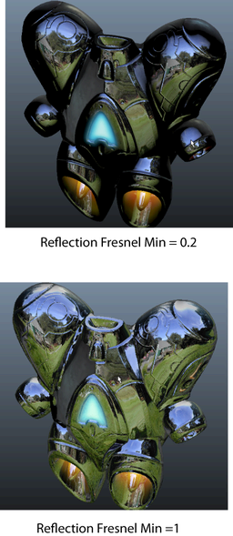

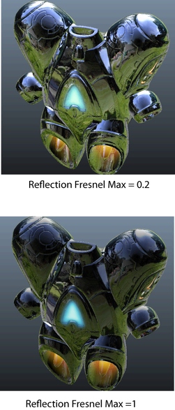

- Reflection Fresnel Min / Reflection Fresnel Max
Use Reflection Fresnel Min and Reflection Fresnel Max to adjust the amount of reflection based on whether a face is parallel to or perpendicular to the camera.
Use Reflection Fresnel Min to add more reflection to the faces of the object that are facing the camera.
Use Reflection Fresnel Max to add more reflection to the faces of the object that are perpendicular to the camera.
These options work best for curved objects.

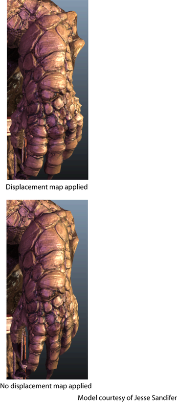

Tessellation and Displacement
- Displacement Model
- Select from the drop-down list whether you are using a greyscale displacement map or a tangent vector map. You can create vector displacement maps in Mudbox. However, you must use the same low polygon model in Maya as you do in Mudbox.
When using a vector displacement map, you usually also want to provide a normal map to the shader to provide the correct normals to the shader after the vector displacement map has moved the vertices.
Note:If you are using .exr files for greyscale displacement maps, you do not need to adjust the Displacement Offset or Displacement Height values and the default settings should work automatically. If you are using .exr files for tangent vector displacement maps, you should set your Displacement Offset to 0 and your Displacement Height to 1.
This does not apply to .tif files, in which case you must adjust the Displacement Offset or Displacement Height values manually.
Note: Select Tangent as your Coordinate Space if you output your normal map from Mudbox. Select Absolute Tangent as your Vector Space if you output your vector displacement map from Mudbox. - Displacement Map
Select Displacement Map to use displacement maps. Displacement maps extrude or indent vertices of your mesh. Displacement maps are especially useful when used in combination with tessellation to generate additional details in your object.
The benefit of displacement maps over normal maps is that shadows pickup the new details of the displacement map.
- Displacement Coordsys
- Select the correct displacement axis for vector displacement maps. The axis is determined by the application from which you generated the vector displacement map, for example, Mudbox.

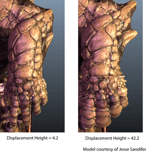

- Displacement Height
- Use this attribute to scale your displacement.
- Displacement Offset
Use this attribute to control the base value for your displacement.
For example, if the offset is set to 0.5, a gray color is not displaced. An offset of 0 would produce an indentation. An offset of 1 would extrude.
Likewise, if the offset is set to 0, a black color is not displaced. An offset of 0.5 would extrude half as much as an offset of 1.0. Indentations do not occur.
- Displacement Clipping Bias
- In cases of extreme displacement, Maya may clip away faces inadvertently. This may occur in scenes with a landscape or objects that are long and wide. Use this attribute to set the maximum displacement to determine when a face of an object is clipped from view. You can also use Bounding Box Extra Scale to avoid inadvertently clipping your object.

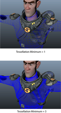

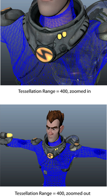

- Tessellation Range
- When you set this attribute, tessellation is controlled by the distance of the object from the camera.
Note: You may find it easiest to enable WireFrameON when adjusting the tessellation settings.
- Tessellation Minimum
Value of tessellation that is constant throughout the mesh. A value of 1 means no tessellation.
Increase the Tessellation Minimum value to increase the resolution.
- Flat Tessellation
- Select this option to blend point normal tessellation (which smooths the edges of the object) with Flat Tessellation (which only tessellates but does not smooth the object). Set this value to 1 to disable the smoothing.

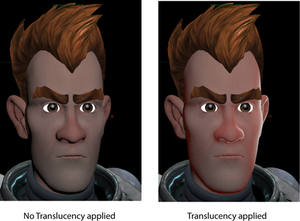

Translucency
- Translucency
- The
Translucency feature simulates light passing through an object. For example, if simulating human skin, the skin becomes more red. Select this attribute to use the options below.
Note: Use these options to add translucency to your object. This option simulates light passing through the object to give it a more realistic look. - Thickness Mask
The Thickness Mask is a texture you render to control the amount of light that passes through certain areas of the skin. For example, non-bony areas with thin skin like the nose would have a reddish color, since a lot of translucency is coming through. By contrast, bony areas would have a darker color in the thickness texture.

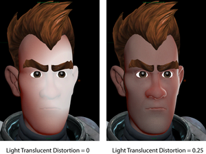

- Light Translucent Distortion
Use this value to set the amount that the normal (per pixel) influences the translucency.
If set to 0, the translucency is uniform over the entire object.
If set to greater than 0, for example 0.5; the translucent effect is no longer uniform but is instead broken up and distorted based on the normal. The result appears more organic.

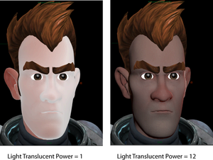

- Light Translucent Power
- Use this attribute to change the focus or size of the translucent areas.

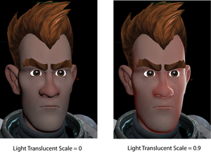

- Light Translucent Scale
- Use this option to adjust the amount of translucency created by the light behind the object. When you adjust the slider to 0, there is no translucency in your object.
- Translucent Minimum
- This attribute sets the amount of translucency that an object always has, even if there is no light behind it.
- Outer Translucent Color / Medium Translucent Color / Inner Translucent Color
- Use these options to change the skin translucency color; for example, for a creature with different colored skin.
