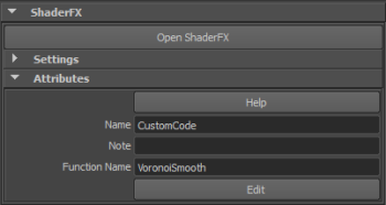

  8. (Optional) To avoid conflict with other nodes, you can also customize the function name by doing as follows:
    1. Name this function VoronoiSmooth instead of the generic name CustomCodexxxx.
      Note: All functions should have unique names. Be careful not to have two Custom Code nodes that have the same function name.
    2. Add VoronoiSmooth_ as a prefix to your other functions, such as hash1 and hash2, and rename the function voronoi to VoronoiSmooth.
    3. Change the Function Name in the Attribute Editor to VoronoiSmooth.

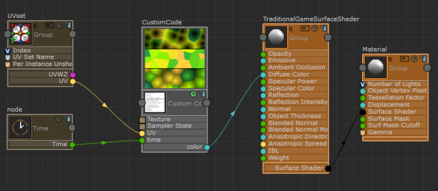

You can now use this code for your custom code node. Connect it as follows, and witness its animation in both the ShaderFX editor and in Viewport 2.0 OpenGL mode.

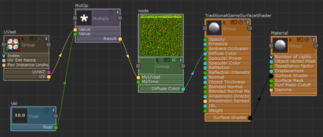

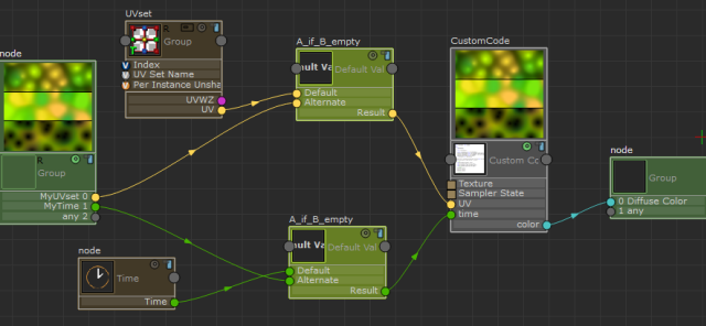

Creating a ShaderFX graph with the Custom Code node
After you have created a Custom Code node using the code above, you can create a network such as the one below.
For more details about creating groups and using the Default Value node, see Provide alternative inputs to the group node and label the group node ports.
In this example, we provide a default UV set and a default time node, while allowing the user to provide an alternate UV set.
