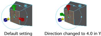

- Local Direction
Enter a value to set the location of the X, Y, or Z point in the local axis. Notice how the manipulator handles change accordingly when you change the Y direction value to 4.0.
