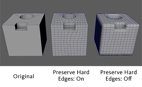

- Preserve: Hard edges
When on, explicit hard edges (those defined using Mesh Display > Harden Edges) on the input mesh are used to influence feature preservation on the retopologized mesh. As a result, features around the hard edges (such as wrinkles, brows, lips, etc) are more accurately converted to the new mesh. However, too many hard edges can cause the retopologize algorithm to run very long. Turning this option off treats all edges as soft edges. See Preserve areas of a retopologized mesh.
Note: The resolution (Target Face Count) of the retopologized mesh determines to what degree the input mesh's shape and edge flow are preserved. For example, a lower Target Face Count value preserves the general shape of the input mesh while a higher Target Face Count value results in a closer match to the input mesh. - Preserve: Edges by angle
