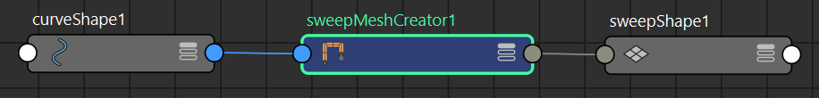

A sweepMeshCreator node is created whenever a sweep mesh is created from a curve (see
Create a mesh from a curve).
When you apply Sweep Mesh to multiple curves at once, they use a single creator node by default, so you can't adjust the attributes of individual curves. If you want to work with each curve independently, (for example, in the case of hair cards,) select and an options window opens so you can choose whether one sweepMeshCreator node is created for all curves or for each curve. See To create a mesh from multiple curves in Create a curve from a mesh with Sweep Mesh.
Conversely, you can use the following command in the Script Editor to make separate creator nodes for each curve:
sweepMeshFromCurve -oneNodePerCurve true;
Set this command to false to return to the default behavior.
Note: A secondary node called
sweepProfileConverter is created when you use the Custom Sweep Profile shape.
