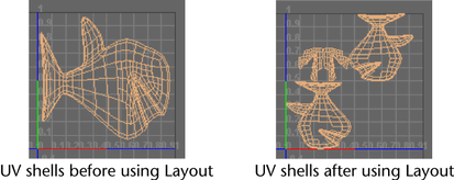

Layout UV shells
The Layout feature automatically repositions UV shells so they don’t overlap in UV texture space and maximizes the spacing and fit between them. This is useful for ensuring that the UV shells occupy their own separate UV texture space. For example, if you are applying Fur to a surface, the UV texture coordinates on a given shell must not overlap.
In general, you should keep UV shells separated for convenience and clarity, but it is not absolutely necessary. For example, you may want the UV shells to overlap so different faces use the same region of a texture.
You can also use the Layout feature to
  • Scale or stretch the UV shells to fit within the 0 to 1 coordinates of the UV Editor. This is useful if you need to maximize the texture space used when creating a texture map. For example, when using 3D Paint.
  • Arrange the UV layout of multiple selected objects simultaneously. This improves your efficiency when you need to quickly sort the UVs for multiple objects within the UV Editor, or when multiple objects need to share different parts of the same texture.
The Layout feature is available from within the UV Editor by selecting Modify > Layout from the UV Editor’s menu bar, or Arrange & Layout > Layout in the UV Toolkit.
Note: Before using Layout you should already have performed the necessary UV mapping. That is, the Layout feature will only arrange existing UV texture coordinates, it will not create them.
