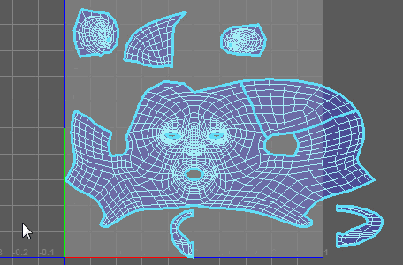

To symmetrize components on a UV mesh
- In the UV Editor, pre-layout the area of the mesh you want to use as a base for symmetrization along a U or V line (does not necessarily have to be the center line).
- Select the Symmetrize UV Tool by either going to , or via the UV Toolkit's .
- Click an edge on the mesh to define the line of topological symmetry.
- Adjust the brush settings as necessary. In particular, make sure to set the Mirror Axis Position, either by adjusting its attribute or Ctrl + middle-dragging the bolded axis in the UV Editor window, so that it properly represents the line in UV space you want to mirror components across.
- Paint along one side of the mesh to symmetrize its components.
