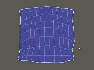

Straighten UVs by aligning them |
Straighten UVs by adjusting their angles to adjacent UVs |
Straighten UVs by matching them to a grid |
You can Shift + click the button to open the Grid UVs Options, which allow you to alter customize the size of the grid that the UVs will align to. Note that this is not necessarily reflected by the visible grid in UV space. |

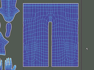

Straighten a selected edge loop and then unfold around it |
Straighten a UV border |

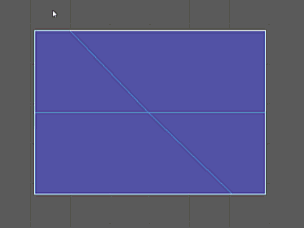

Straighten UVs
You will often need to straighten UVs along the same edge loop in order to fix distortions on a UV map. There are a number of different ways to do this:
