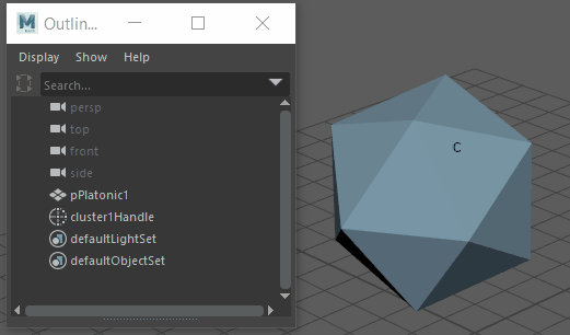

The cluster deformer is created and a small C icon - the cluster handle - displays on the object.
Tip: You can control the placement of the cluster handle by changing the handle’s Origin values in the Attribute Editor. Select the handle, find the clusternHandleShape tab in the Attribute Editor, and set the Origin X, Y, and Z-axis values you want.

To select a cluster deformer handle
- Select the area with the cluster "c" icon.
- Shift-select to exclude everything else from the selection.
Select the "c" and shift-select to remove everything else, or select the clusterhandle in the Outliner.
