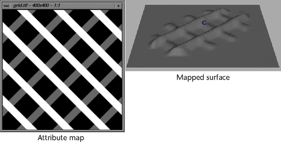

Mapping weight values to clusters
Using the Paint Cluster Weights Tool you can map attribute values onto surface vertices relative to the UVs. The settings for the tool are applied to the cluster vertices using the mapped values.
In the following example, notice that only the cluster is affected by the map.
For details on mapping, see Map attributes.

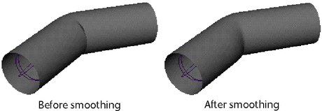

Painting weights on rigid skin objects
When using rigid skinning, Maya creates a joint cluster node for each joint of the skeleton. The joint cluster nodes assign weights to the rigid skin points to control how the rigid skin objects deform. You can use the Paint Cluster Weights Tool to modify the rigid skin point weights.
In the following example, notice how the surface folds at the joint. You can use the Paint Cluster Weights Tool to quickly smooth out the fold.
Note: Painting smooth skin point weights requires the use of a different painting tool. See Painting smooth skin point weights.
