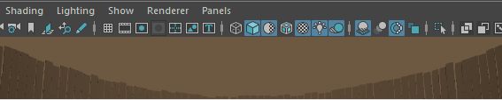

In-view Messages
In-View Message example
- Enable
Shows or hides all in-view messages. The default is on.Note: You can also show or hide In-View Messages in the Heads Up Display options.
- User assistance messages
Shows or hides messages that explain how to perform operations. The default is on.
- Status information messages
Shows or hides messages that provide information about a change in Maya's status. The default is on.
- Display time
Sets how long the tool message appears on screen, in seconds. The default is 2 seconds.
- Font size
Sets the text size of the in-view message, in points. The default is 12 points.
- Background opacity
Sets the opacity of the in-view message background, as a percentage. The default is 75, with 0 being fully transparent and 100 being fully opaque.Note: In Maya for Linux, the Background opacity option is only available when running a window manager that supports compositing.
