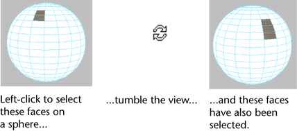

Disable pick chooser for components
Choose to have pop-up selection on for objects, and off for components. This is useful to prevent the following situation: you have the Pick Chooser menu turned on and you’re in component mode, you can accidentally select faces or vertices on the opposite side of an object when you don’t want to (this is most obvious when Select faces with whole face is on).
This behavior is a consequence of the Pick Chooser menu. To make sure that only the clicked-on components are selected, turn on Disable Pick Chooser for Components.

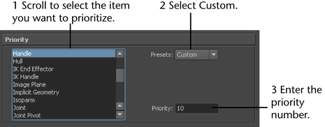

Priority
You can specify a selection priority for objects and components. By default, NURBS curves have a higher selection priority than surfaces. This means that Maya selects the NURBS curve before the surface when you select geometry that contains both NURBS curves and surfaces.
Note: Priority selection can be set for Custom presets only. Other contexts such as Animation and Rendering are preset, but can be viewed here.
