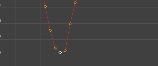

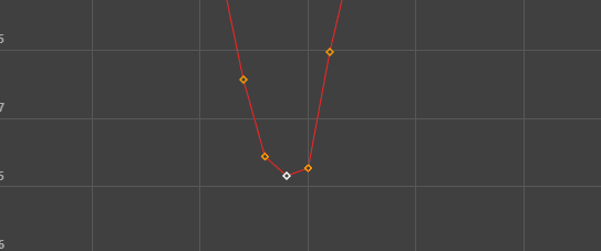

- Auto-adjust key size on zoom
Auto-adjust key size on zoom on
- Turn on this option so that Graph Editor keys resize to stay in scale with the curve when zooming in the Graph Editor Graph view. If unchecked, keys stay the same size regardless of how far you zoom out.
Auto-adjust key size on zoom off

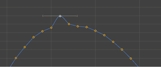

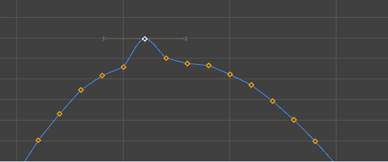

- Tangent handle size
Adjusting the Tangent handle size
- Enter a value or use the slider to make the Tangent handle larger or smaller.
- Tangent Line thickness
Adjusting the Tangent arm size
- Enter a value or use the slider to make the Tangent arm thicker or thinner.
