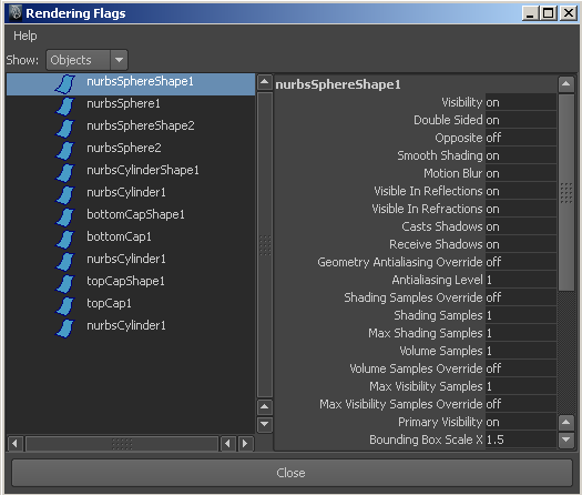

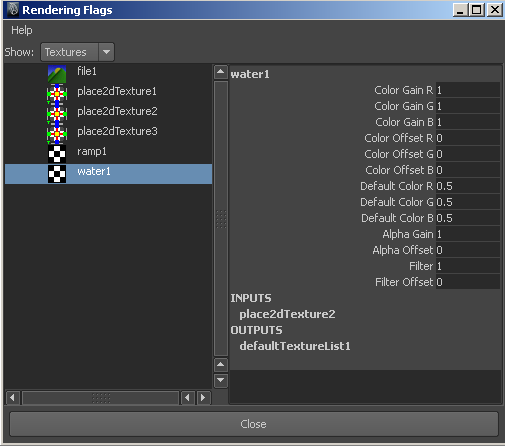

To set attributes for nodes in the Rendering Flags window
  1. Click Windows > Rendering Editors > Rendering Flags.
  2. In the Rendering Flags window, from the Show drop-down list, select the item(s) for which you want a list of attributes.
    The attributes for these items are listed in the right panel where you can change and set them, much like in the Channel Box.
  3. Do one of the following:
    • To change the attributes of one node, click the listed node in the left panel to display the attributes in the right panel, then change the attributes.

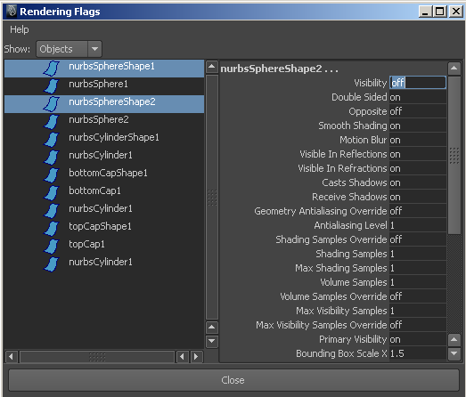

    • To change attributes for several related objects by selecting them in the left panel of the Rendering Flags window, and setting the attribute value in the right panel. For example, if you want to turn the visibility off for two NURBS spheres in the scene, select both spheres from the left panel and type off beside Visibility in the right panel.
    Once you change an attribute for a selected item, the heading changes color in the list, reminding you of the change.
