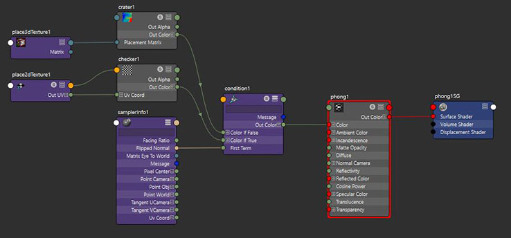

To create a double-sided shaded surface
- In the
Hypershade, create one of each of the following:
- Material (this procedure uses a Phong material).
- A Sampler Info utility. The Sampler Info utility provides access to camera and surface information that you can pipe into your shading networks during rendering.
- A Condition utility. The Condition utility lets you specify which texture is mapped to each side of the surface.
- Checker texture.
- Crater texture.
- Assign the Phong material to the surface.
- In the Hypershade, connect the Checker’s Out Color attribute to the Conditions Color If True attribute .
- Connect the Crater’s Out Color attribute to the Condition’s Color if False attribute.
- Connect the SamplerInfo Flipped Normal attribute to the the Condition’s First Term or Second Term attribute.
- Connect the Condition OutColor attribute to the Phong Color attribute.

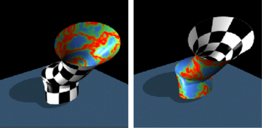

- Perform a test render.
Maya shades each side of the surface with a different texture.
Image of resulting connections in the Hypershade.

- Select the Condition node. In the Property Editor, Condition Attributes section, change the Operation attribute to Not Equal (or if it is set to Not Equal, change it to Equal).
- Perform a test render. The following shows the result.
