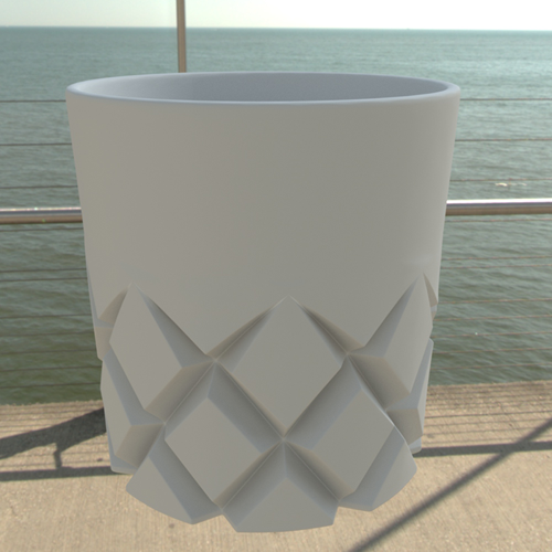

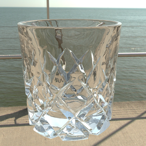

  1. Select your model, then right click and select Assign Favorite Material > Standard Surface. A standardSurface2 shader is now assigned to your glass model.
  2. In the Standard Surface Attribute Editor, lower the Specular > Roughness to 0.
    If you are modeling a clear glass, you do not need to set a roughness value. As you lower this value, your specular reflections now appear glossier, and your render will also be faster as a result.

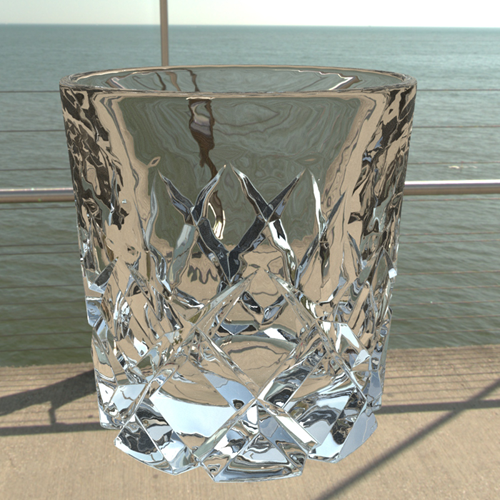

  3. To make the glass transparent, adjust the Transmission > Weight. This allows light to scatter through a surface, and is ideal for modeling glass or water.
    Set this to a high value, for example 0.95, for glass.
  4. Lower the Base > Weight value so that your combined Base > Weight and Transmission > Weight values equal to 1. In other words, set Base > Weight to 0.05 because Transmission > Weight is set to 0.95.
    The Standard Surface shader is energy conserving by default: all of its layers are balanced so that the amount of light leaving the surface does not exceed the amount of incoming light. By setting your layer weights to 1, you ensure that your material is energy conserving and that it will react predictably in different lighting.
  5. Increase Specular > Weight to capture the specular contribution from direct light sources. The higher the weight, the brighter the specular highlight.
    Specular weight is set to 1 in the following image.

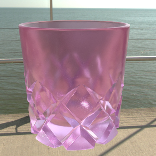

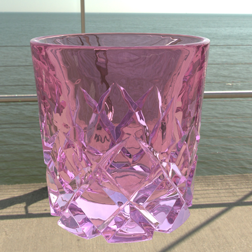

  6. To add variety to your glass, adjust attributes such as the Transmission > Color to tint your glass.

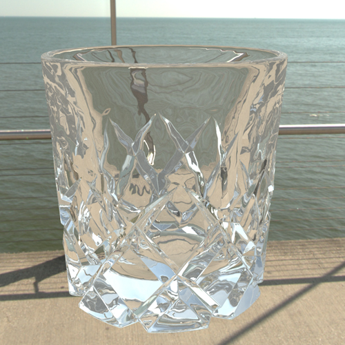

  7. To create frosted glass instead of clear glass, increase the Specular > Roughness.
    A roughness value of 0 gives a perfectly sharp mirror reflection, while higher values create reflections that are closer to a diffuse reflection. In this example, a value of 0.177 is used.

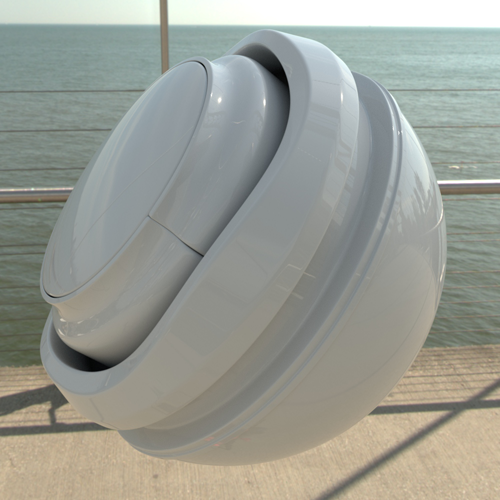

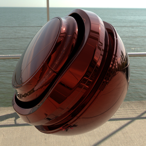

  2. In the Standard Surface Attribute Editor, lower the Specular > Roughness to 0 to create a chrome material.
    The lower the Roughness value, the sharper the reflection. A value of 0 produces a perfectly sharp mirror reflection.
  3. Set Specular > Weight to 0.8 to capture the specular contribution from direct light sources. A higher value produces a brighter specular highlight.
  4. Set Base > Metalness to 1 to turn your surface into a metal.
  5. Set Base > Color to tint your metal.

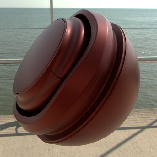

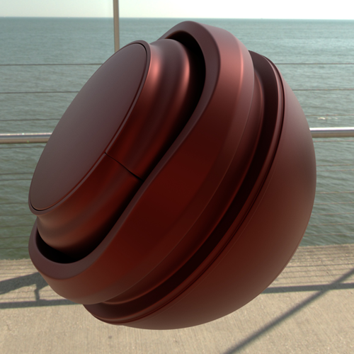

  6. If you are modeling car paint, you can create a matte finish instead of a glossy one by adding Specular > Roughness.
    In this example, Roughness is set to 0.45.

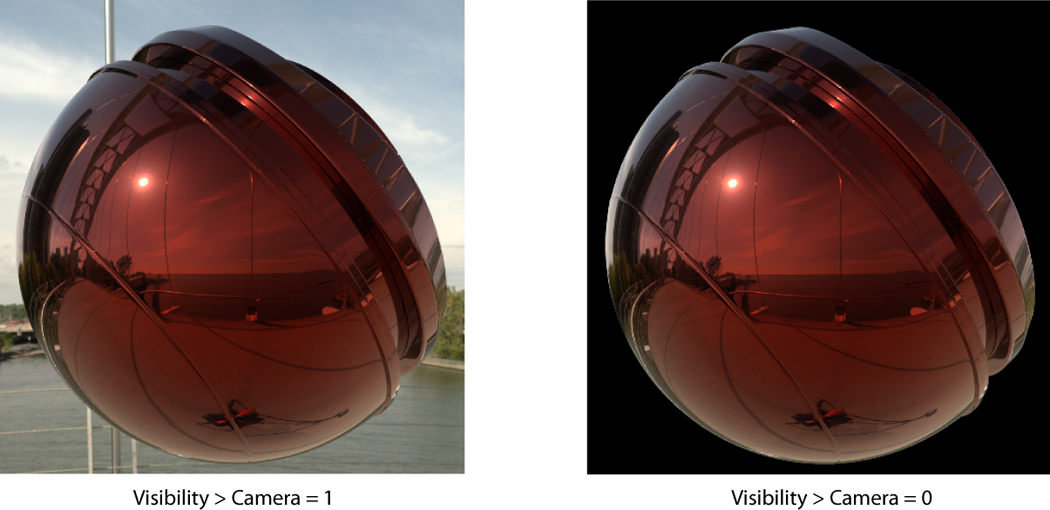

By default, the .hdr image used for environment lighting is included in the background. To exclude it from your final render, select the aiSkyDomeLightShape Attribute Editor, then set Visibility > Camera to 0.
