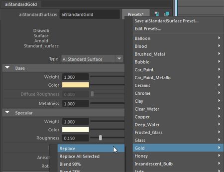

Presets such as Clear_Water, Frosted_Glass, Gold, and Car_Paint are available. Click Presets* in the aiStandardSurface Attribute Editor or Property Editor to select the preset you want.

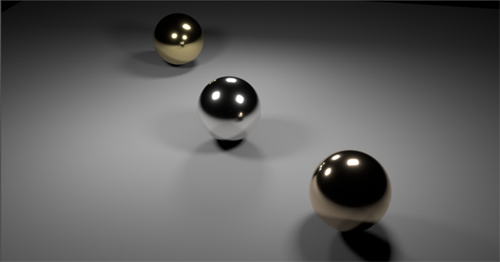

    In this scene are three spheres, each with an aiStandardSurface shader assigned, and with the Gold preset applied. The Base > Color and Specular > Color of the silver and copper spheres have been modified to reflect their respective color.

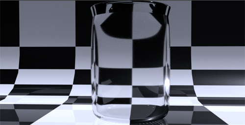

  4. In this scene is a glass jar with an aiStandardSurface shader assigned, and with the Glass preset applied.
