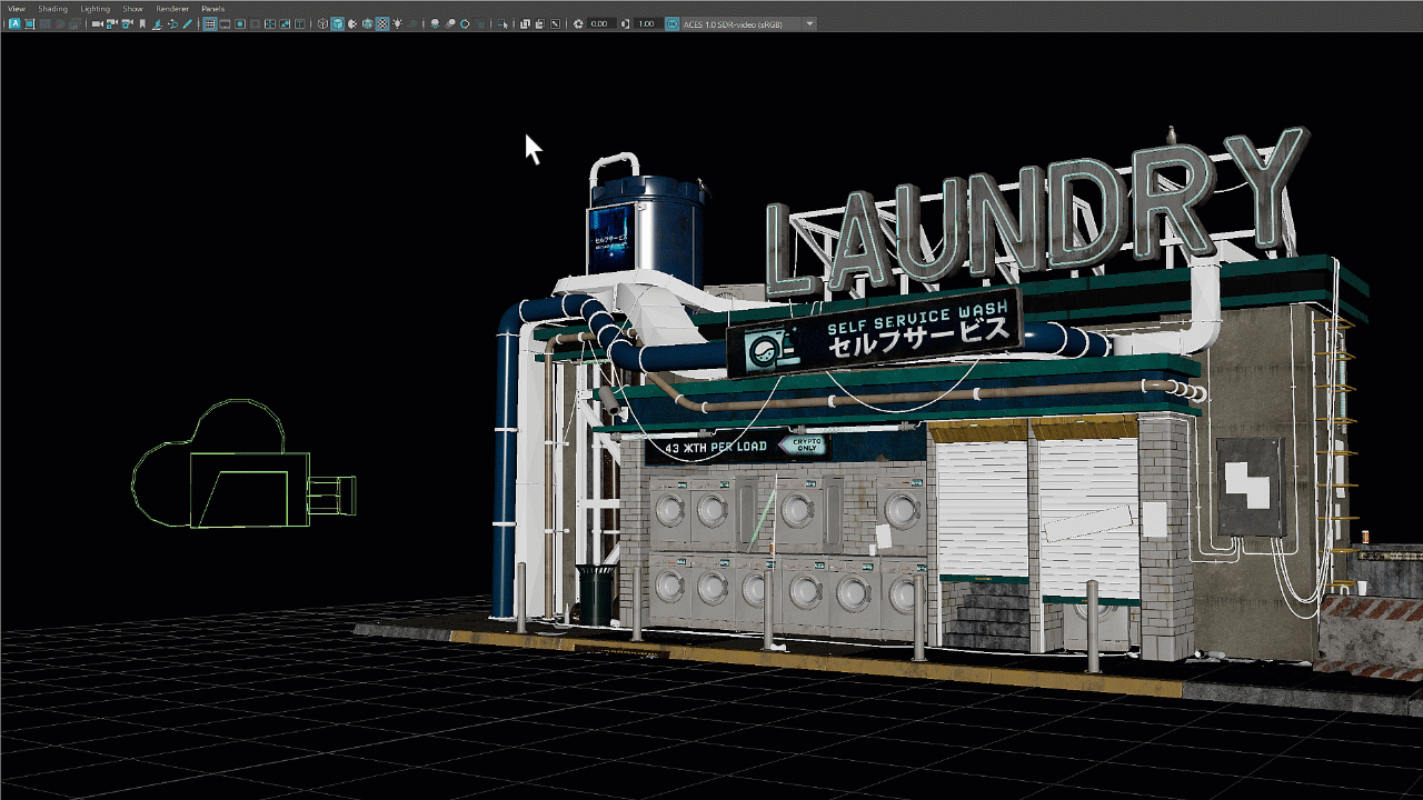

  • Control USD cameras in the native Maya viewport. With USD for Maya 0.30, you can now use the native Maya viewport's camera controls, such as tumbling, tracking and dollying, to manipulate USD cameras.
    gif for
