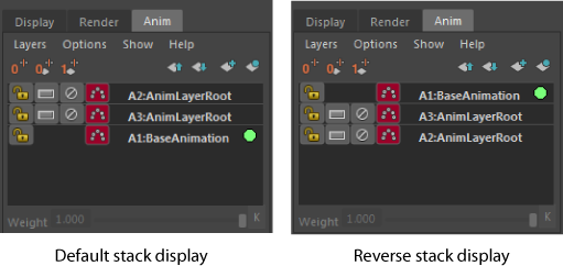

Animation layers are stacked in the Animation Layer Editor in the order that you create them. By default, layers are stacked bottom-to-top, meaning new layers are added at the top of the layer pane, and existing layers are pushed down.
If you prefer, you can change the stack to display layers top-to-bottom, with new layers being added at the bottom of the layer pane. (See Change the animation layer stack display.)
Note: In this documentation, the default stack display is assumed.
No matter which way you choose to display the stack, the animation layers are always effectively stacked on top of the BaseAnimation.
