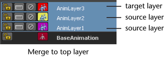

- Merge Layers
- Merges the selected animation layers. See Merge animation layers.
- Merge Layers >
- Opens the Merge Layer Options. Select from the following options.

- Merge To
- Set which direction you want the merge to occur in the stack. Select from the following options:
- Top Selected Layer
- Merges the selected layers to the selected layer that is highest in the stack. (The highest layer in the stack is the ‘target’ layer, all other layers are ‘source’ layers.)
- Bottom Selected Layer
- Merges the selected layers to the selected layer that is lowest in the stack. (The lowest layer is the ‘target’ layer, all other selected layers are ‘source’ layers.)
