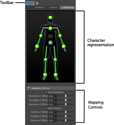

  • Open HumanIK (Skeleton > HumanIK) and select the Custom Rig tab at the top.
Custom rigs are typically driven by some combination of ikHandles, constraints and other miscellaneous nodes. The Custom Rig tab provides a visual interface for mapping your custom rig, and retargeting tools to transfer data from other HumanIK defined characters.
The Custom Rig tab contains the following main areas:
The following table provides a brief overview of tasks using the Custom Rig tab.
