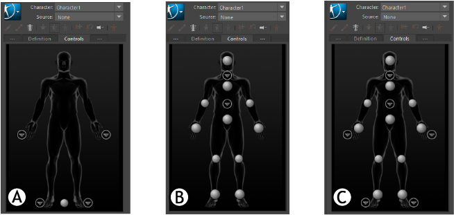

- Edit Control Rig

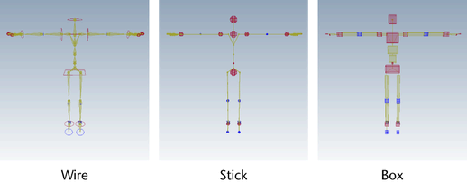

- Rig Look
Lets you select what style of Control rig effectors to work with.
- Align/Synchronize Control Rig
When on, the IK and FK effectors of the Control rig always appear synchronized, even if they interpolate differently between keyframes. Disable this option if you want to view separate interpolation paths for the IK and FK solutions.
When using Full Body or Body Part modes, this feature gives you synchronization for manipulating and keying of the Control rig. Note that this feature does not apply to Selection mode.

- Load UI Configuration
Opens the Import UI Configuration File dialog box, letting you select a custom configuration file to be used as the new default layout for the Controls tab. See Load a new layoutand HumanIK Character Controls templates.
The three Character Controls templates that are installed with Maya
- Save UI Configuration...
- Refreshes the Controls tab layout. Use this option to view changes you make to your configuration file after it is loaded using the Load UI Configuration command.
- In Maya 2016, this option is called Update UI Configuration.
