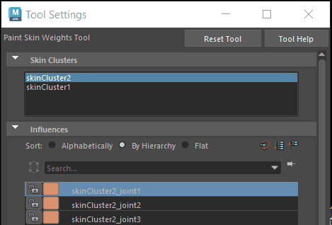

Skin Clusters
The Skin Cluster area lets you control individual skin clusters on geometry that has more than one skin cluster applied. If you select a skin cluster in the Skin Clusters list, the Influence section also updates with data about the selected skin cluster.
The Influences list and Skin Clusters list are linked
- Skin Cluster list
- If you add more than one
skin cluster to the scene, it appears here. See
Manage multiple Skin Clusters for more.
Note: If no skin cluster is selected, this list remains empty.
- The most recently added skin cluster appears at the top of the list.

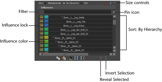

- Influences list
This area displays a list of all influences bound to the selected mesh. For example, all joints that influence skin weights for a selected character mesh.
Tip: Use the Size controls above the Influences list to expand the panel and view more influences.
Within the Influences list, you can use the following controls.
- Filter
Enter text to filter the influences that display in the list. This can make it easier to locate and select influences you want to work with, especially if you have a complex rig.
- Pin icon
Pins the influence list to display only the selected influences.
- Influence Lock icons
Lets you lock and unlock each influence from receiving weight as you paint.
- Influence color buttons
Opens the Influence color window, which lets you assign a new color to the selected influence.
- Copy weights
Click to copy the weight value of a selected vertex. See Copy smooth skin weights.
- Paste weights
Click to paste a copied vertex weight value to other selected vertices.
- Weight hammer
Click to fix selected vertices that have weights causing undesirable deformation on the mesh. Maya assigns the selected vertices with the same weight values as their neighboring vertices, resulting in smoother deformation. See Fix smooth weights.
- Move weights
Click to move the weight values of selected vertices from the first selected (source) influence to other selected (target) influence(s). See also Move weights to other influences.
When you click the Move weights button (or select Skin > Edit Smooth Skin > Move Weights To Influences), the weight values of the selected vertices are removed from the selected source influence and re-assigned to any selected target influence(s).
Note: Re-assigned weights may also be normalized if you have the Normalize Weights mode set to Interactive. - Show Influences
Click to select all influences that affect the selected vertices. This can help you troubleshoot areas of the mesh where you find unexpected deformations.
- Invert Selection
Click to quickly reverse which influences are selected in the list. This option is useful in conjunction with the Influences list hold and un-hold buttons.
For example, select only those influences you want to work with, then click Invert Selection to change your selection to all other influences in the list. You can then click to hold all other influences.
- Reveal Selected
Click to automatically scroll the Influences list to display the selected influence. This can be helpful when working with a complex character that has many influences.

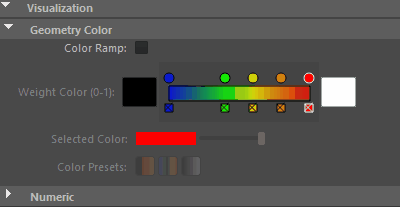

- Geometry Color
- These settings let you show weighting in a color gradient.
- Color Ramp
Turn on this option to show weight values in color on the mesh. This can make it easier to see small values when painting, and to determine whether a joint is influencing vertices where it should not. For more information on using color ramps, see Set attributes using ramps.
Different Color Ramp types
When Color Ramp is on, you can use the Weight Color ramp and Selected Color options to customize the color ramp. You can also select one of the Color Preset options.
- Weight Color (0 -1)
When Color Ramp is on, this area lets you edit the color ramp. Click the swatches on either side of the ramp to set colors to represent values of 0 and 1, or select part of the ramp and click the Selected Color swatch to re-set that color.
- Selected Color
Click to open the Color Chooser window and set a new color for a selected part of the color ramp. Only available when Color Ramp is on.
- Color Presets
Select from three pre-defined color ramp options.

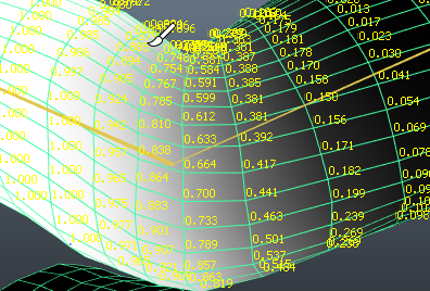

- Numeric
Weighting with both color ramp and numeric values
- These settings let you show weighting values as numbers.
Note: Weight values of 0.00 are hidden. Increase the value of the Decimal Places setting to show more precise weighting values
- Show Numbers
- Turn on this option to display the weighting influence values as numbers.
- Decimal Places
Skin weight showing 3 Decimal Places
- Lets you set the amount of numbers the influence weighting shows, (for example, 1.25, 1.255, or 1.2555,) to create exacting weighting effects. The default is 2.

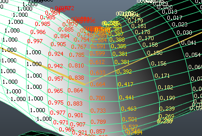

- Number Color
- Click the color swatch to open the Color Chooser or use the slider to select a color for the Weight Values.
- Color Ramp
Skin weight using a Color Ramp
- Activate this option to show weight value numbers in a color gradient.

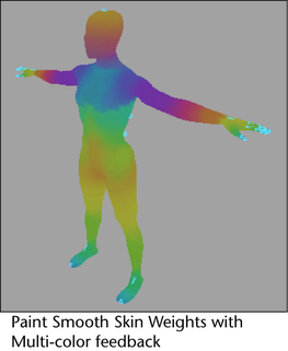

Turn on this setting to view the distribution of painted skin weights on your bound geometry as multi-color feedback. The colors that appear on your bound pieces of geometry correspond to the colors of their skeletons’ joints and bones, and they indicate the areas of skin each of their joints affect. You can view Multi-color Feedback in the scene view when in Vertex mode or when using the Paint Skin Weights Tool.
