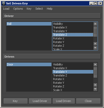

- Select the door, then select
Key > Set Driven Key > Set.
The Set Driven Key window appears with the door in the Driven list.
- Select the ball in the scene view, then click
Load Driver.
The ball appears in the Driver list.
- Select
Translate Y in the
Driven list (the attribute to be driven by the ball’s movement), and select
Translate Z in the
Driver list (the attribute that will drive the door), then click
Key.

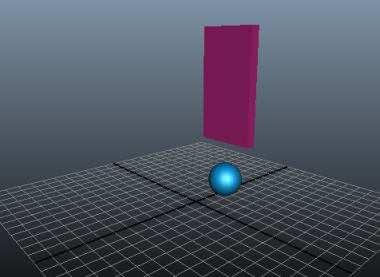

- Use the
Move Tool (hotkey
W) to position the ball directly on the door, then move the door to a position above the ball.
- In the
Set Driven Key window, click
Key.
This sets another driven key that links the current Translate Z value of the ball to the Translate Y value of the door.

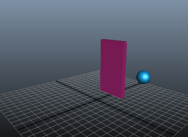

- Move the ball past door and then lower the door to its previous position.
- In the
Key.
You’ve set three driven keys that link the attribute values at different positions. If you drag the ball toward the door from either side, the door rises smoothly. You can also flip through your driven keys by selecting Key > Go To Next or Key > Go To Previous in the Set Driven Key window.
