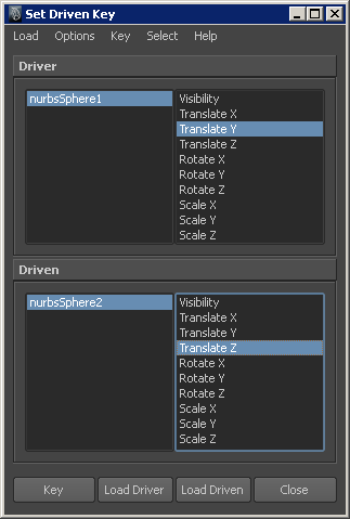

  1. Select the object with attributes you want to be driven, then select Key > Set Driven Key > Set (from the Animation menu set).
    The Set Driven Key window appears, listing the selected object as the driven object.
  2. Select the object with attributes you want to act as the driver, then click Load Driver in the Set Driven Key window.
    Note: The driven and driver objects can be the same object.
  3. Select an attribute from the Driver list, then select an attribute from the Driven list, and click Key.
    This creates an association between the selected attributes at the current values.
  4. Change the driver object attribute values, and repeat the step above as many times as you like, creating as many different associations as you need between the pair of attributes. (See also Set Driven Key example.)
Tip: To add an object to the existing Driver or Driven list, turn off Options > Clear On Load in the Set Driven Key window before clicking Load Driver or Load Driven.

  • You can’t select two driver attributes at the same time in the Set Driven Key window. You can set a key for only one driver attribute at a time, so you have to key each driver attribute to a driven attribute separately. You can select and key multiple attributes in a driven object.
  • When you load two or more objects into the Driver or Driven lists, no attributes appear for the objects. Click an object in either list to select it and see its attributes.
