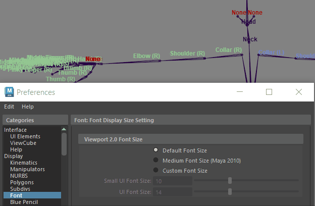

    • If Joint labels are too small, adjust the joint label text size using the option in the Preferences window Font section (Preferences > Font > Viewport 2.0 Font Size > Custom Font Size > UI Font Size).
      Use the Preferences Custom Font Size to show larger Joint Labels
