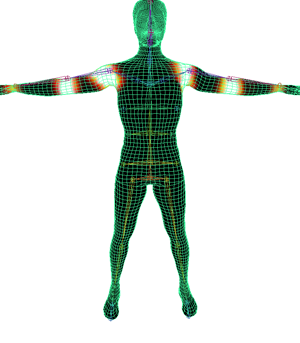

    The following example image displays weights using one of the default Color presets in the Interactive Skin Binding Tool.
    White areas indicate vertices with weight values of 1, meaning their influences have a fully dual quaternion affect. In these areas, volume is preserved as you rotate the influence. Yellow, orange, and red areas indicate vertices with weight values of less than one, so the influence will have a blend of dual quaternion and linear skinning and some volume loss can occur. Black areas of the mesh indicate that vertices have weight values of 0, meaning their influences are set to full classic linear skinning.
