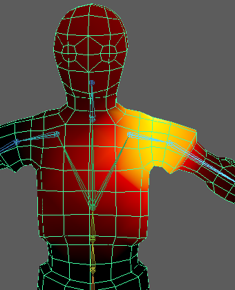

Setting the Bind Method to Closest Distance tells Maya to ignore the skeleton’s hierarchy. Instead, the joint that has the next greatest influence on a smooth skin point’s weight is always the next closest joint to the point. Depending on the structure of the skeleton and the placement of the model, this joint can be much higher or lower in the skeleton’s hierarchy than the closest joint. For example, if your character’s arms are hanging down so that the forearm bones are near the hip bones, the hip bones can have the second greatest influence over the skin points for the arms. This can lead to an in appropriate influence on the weights of the arm skin points.
The following illustration uses the Paint Skin Weights tool to show the effect of the Closest Distance bind method. The yellow center depicts where the influence is strongest, and the black areas reflect the decrease in the bind's effect as it spreads through the mesh. With this bind method, the default settings shows the influence strongest in the shoulder, but extending as far as the top of the head. If you compare the Closest Distance and Closest in Hierarchy illustrations, they both show similar effects, although Closest in Hierarchy spreads more completely through the chest area.

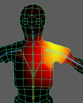

Setting the Bind Method to Closest in Hierarchy tells Maya to consider the skeleton hierarchy. The joint that will have the next greatest influence will be a relative (parent or child) of the closest joint. For example, if your character’s arms are hanging down so that the forearm bones are near the hip bones, you can make sure that the skin points for the arms do not come under the influence of the hip bones. This is because the hip bones are not near the forearm bones in the skeleton’s hierarchy even though the distance between them is small.
This illustration uses the Paint Skin Weights tool to show the effect of the Closest in Hierarchy bind method, where the yellow center depicts the strongest influence and the black areas show the decrease in the bind's influence. With this bind method, the default settings show how the influence of this method spreads to the character mesh's chest and head. If you compare the Closest Distance and Closest in Hierarchy illustrations, they both show similar effects, although Closest in Hierarchy extends further into the chest area.
