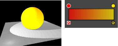

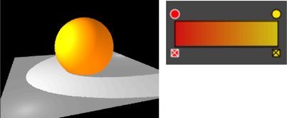

The Ramp Shader is a material (shader) that you can use for extra control over the way color changes with light and the view angle. You can simulate a variety of exotic materials and tweak traditional shading in subtle ways.
All the color-related attributes in the Ramp Shader are controlled by ramps (gradients). Graphs let you avoid complex shading networks by making certain looks, like toon shading, easier to achieve.
You can set the many attributes of the Ramp Shader to control the appearance of objects.

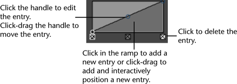

Each color entry in a ramp has a circular color handle above the ramp, and a square color icon below the ramp. The active color has a white border around its color handle and icon.
See Set attributes using ramps for more information on how to customize your ramp by adding additional color entries.

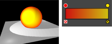

Color: two entries, black at 0.5 and surface color at 1.0
With Interpolation > Linear, this should be the same as a normal lambertian falloff. Using Interpolation > Smooth makes the linear shading artifacts disappear.

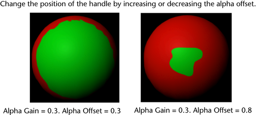

Click the handle above the ramp to select it. Right-click the Selected Position attribute in the Attribute Editor (or Ramp Editor) and choose Create New Texture to map a texture.

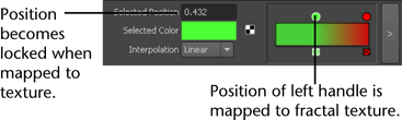

After you have mapped a texture to the position of a handle, the position field becomes locked (the text box appears yellow). The position is now fully defined by the texture that you have chosen.
To alter the position of the handle, expand the Color Balance section of the texture in the Attribute Editor. Increase or decrease the Alpha Offset value.
To alter the effect of the texture, increase or decrease the Alpha Gain value.

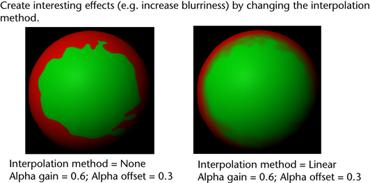

For more interesting effects, you can also alter the Interpolation method of the ramp in the Attribute Editor. See Interpolation for more information.
You can map textures to your ramp in both the Ramp Editor and within the Attribute Editor. However, you only see the effect of the texture in the material sample swatch and in the shader icon (in the hypershade), not in the Ramp Editor.
Consider the following example. Two color entries have been entered into the ramp, the first of which has its position mapped to a fractal texture.

Interpolation

- Interpolation
Controls the way values are calculated in the ramp. Select an option from the drop-down list: None, Linear, Smooth, Spline. The default is Smooth.
- None
There is no interpolation; the different colors show up as different bands in the final texture.
- Linear
The values interpolated linearly in RGB color space.
- Smooth
The values interpolated along a bell curve, so that each value on the ramp dominates the region around it, then blends quickly to the next value.
- Spline
This takes into account neighboring indices for a smoother effect.
