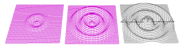

To create a wave deformer
- With the plane selected, create a wave deformer for the plane with the following creation options:
- Min Radius: 0
- Max Radius: 1
- Amplitude: 0.2
- Wavelength: 0.4
- Dropoff: 1
- Offset: 0
The result follows:

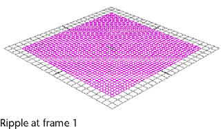

To key ripple at frame 1
- In the Time Slider, select frame 1.
- In the
Channel Box, set wave1’s attributes as follows:
- Amplitude
0.0
- Max Radius
0.1
- Set keys for all of wave1’s attributes.

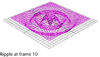

To key ripple at frame 10
- In the Time Slider, select frame 10.
- In the
- Amplitude: -0.2 (negative value allows first wavelet to go down)
- Dropoff Position: 0.5
- Max Radius: 1
The result is as follows:

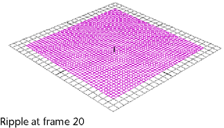

To key ripple at frame 20
- In the Time Slider, select frame 20.
- In the
- Min Radius: 1
- Amplitude: -0.1
