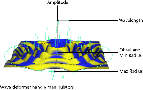

To edit wave deformers by using handle manipulators
  1. Select the wave deformer node (default name: waven).
  2. Select the Show Manipulator Tool (default shortcut: t key).
    Tip: Offset and Min Radius manipulators are both at the center of the handle by default.
  3. In the scene, select one of the manipulators on the wave deformer handle.
    The manipulators on the wave deformer handle let you edit attributes.
  4. -drag the mouse to edit interactively. Note that the Channel Box updates the values you are changing.
    The Offset and Min Radius manipulators are both located at the center of the handle by default.
