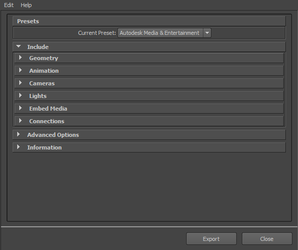

- The FBX Export options appear at the right of the Maya Export dialog box.
- Set the export options you want to use or select a preset from the
Presets menu. The
Autodesk Media and Entertainment preset contains the best balance of options for a general animation workflow. The
Autodesk MotionBuilder preset contains options set for character animation using Maya and MotionBuilder.
See Import Presets Options in the FBX Import options topic for more information about presets.
Important: If your file contains textures and maps, it is important to activate the Embed Media option. Embedding Media stores the media within the FBX file itself, which impacts file size. Use this option only when you transport an FBX file to a location where the original media source is no longer accessible by the receiver.
