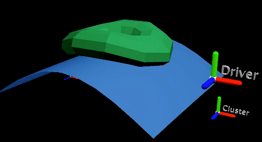

In the preceding example, the blue plane is the driver, affecting the green torus. The vertices of the blue plane are deformed by Morph and Cluster deformers.
The Morph deformer creates the bend in the plane but is not scaling or rotating it. The Cluster deformer visually "scales" the geometry by moving the verts but note that the driver does not know this actually represents a scaling. The Transform of the driver adds another level of scaling and translation.

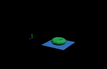

When using only the moved verts, the torus seems flattened
When the driver only uses the moved verts, the torus appears to become flattened since it stretches with the plane but maintains its original height. This is because the Proximity Wrap is not using any actual transform information, only the moved driver verts.

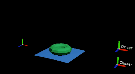

If you want to the driver to take the Transform into account, deactivate the Use Transform As Deformation option in the Driver area of the Attribute Editor Proximity Wrap settings. (See Driver Attributes in the Proximity Wrap options.
If you turn off Use Transform As Deformation with the example above, the torus scales with the Driver. However, the torus does not react to the "scaling" added by the Cluster deformer.
With Use Transform As Deformation turned off, the torus scales with the Driver but not the Cluster deformer

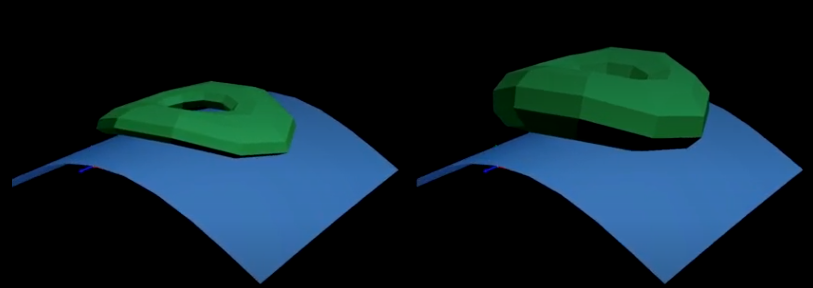

Left: Only moved verts used, Right: all transformation used.
