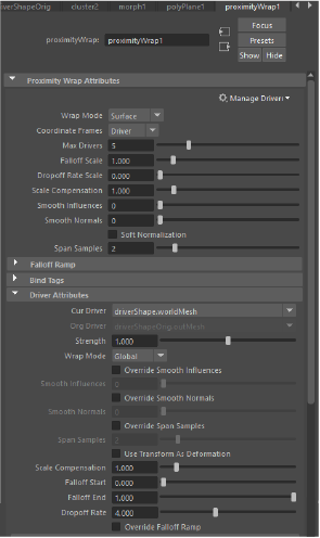

Attribute Editor
ProximityWrap1 tab in the Attribute Editor
- Proximity Wrap Attributes
- Many of these settings are defined in the Proximity Wrap Basic tab, above. The following additional settings appear only in the Attribute Editor Proximity Wrap tab.

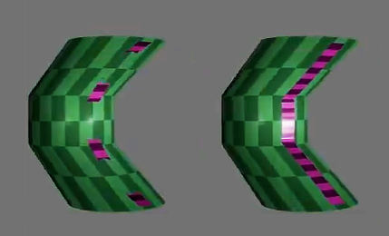

- Coordinate Frames
Lets you set which way that the surface binds to the frames of the driver vertices:
Coordinate frames setting: Driver (left) and Snap (right)
- Driver: Binds the coordinate frames associated with the verts of the driver to the deformed geometry. This settings is the default, however, if you want the deformation to adhere less to the deformed geometry, use the Coordinate Frames Snap option.
- Snap: Binds driver vertices directly to a single polygon of the driver, creating a more linear effect (see the comparison example above).

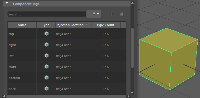

- Bind Tags
Use Bind Tags to fix unexpected vertex assignments
- If unexpected results occur on your deformed mesh, activate the Bind Tags option. The deformer misassigning vertices to random driver vertices on the tagged geometry creates the tearing effect in the deformed geometry in the animation above. This happens when default Component tags create conflicts with the position of the driver vertices.
- The Bind Tags filter lets you sort for the Component Tags with operators (see Component Tag expressions for more information about the operators you can use to filter).
Note: Component Tags are included with some primitives by default. If you don't want them applied, go into the primitive Tab (for example, Cube1) in the Attribute Editor and turn off the Component Tag Create option.
The default Component Tags of polyCube1.
- Driver Attributes
- Set the following driver attributes to deform your geometry.
