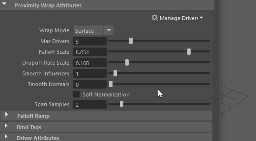

  5. With the Proximity Wrap deformer object/node still selected, open the Attribute Editor.
    Note: Maya creates a Proximity Wrap deformer node for each object you want to deform, so you will see Proximity Wrap 1, Proximity Wrap 2, and so on as tabs in the Attribute Editor.
  6. In the Attribute Editor, switch to the Proximity Wrap1 tab, expand the Proximity Wrap Attributes and pin the tab using the Pin Tab icon .

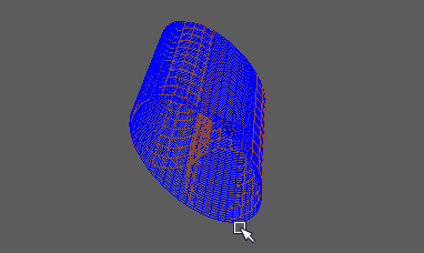

  7. Select a primitive to represent the driver of the deformation in the Outliner, the Viewport, or the Node Editor.
  8. In the Attribute Editor Proximity Wrap1 tab, expand the Manage Drivers menu and select Add Selected as Driver. The selected primitive becomes the driver is created and connected to the deformer.
    Note: To add multiple driver geometries, Shift-select the geometry before clicking Add Selected as Driver in the Manage Drivers menu.
  9. To configure the settings for new drivers, select Edit New Driver Defaults to open the Proximity Wrap Drivers window.
  10. You can transform the geometry of the driver to influence the binding or to deform the target geometry.
