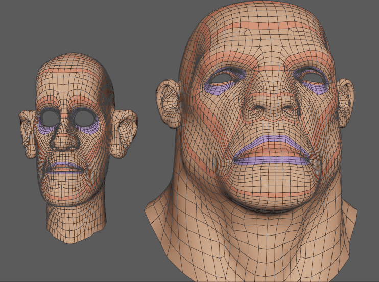

Use the Morph deformer to transfer animation from one geometry to another by scaling morph displacement on a per-vertex bases, based on the delta of the coordinate system at each vertex. In the example above, the animation is transferred from the smaller head on the left to the large head on the right.
Note: The target and source geometry must have the same topology, that is, an identical number of vertices, edges and faces for the retargeting to work smoothly.

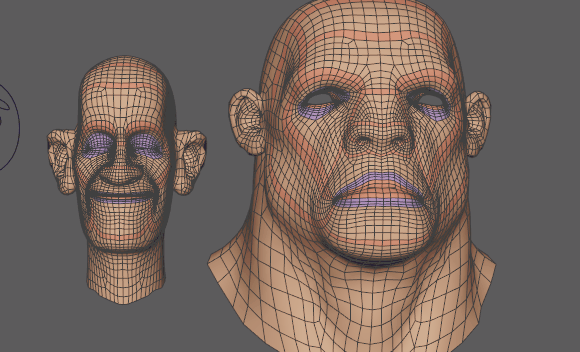

- Click Apply. The Source object adopts the deformation of the deformed object.
- In the example, because the head receiving the animation is much larger than the originating head, tears appear in the mesh. If this occurs, use the
Neighbor Exponent setting in the
Attribute Editor
Morph tab to correct the problems and smooth the result.
