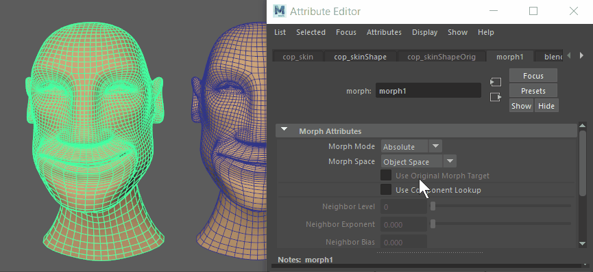

Basic Tab

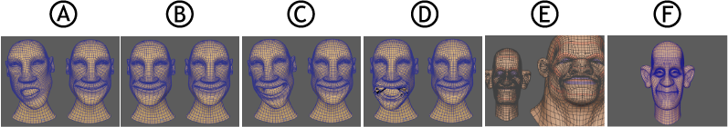

- Morph Mode
- Set how the Morph target object modifies the geometry.
Morph modes: A. before deformation, B. Absolute, C. Relative, D. Surface, E. Retarget, and F. Mirror
Setting Behavior In the illustration above, (A) shows the geometry before the Morph deformer is applied. Absolute (B) Takes the exact value of the deformed object. Relative (C) Lets you modify your deformation relative to its current value. Surface (D) Matches the surface deformation. Note: If the deformation is very different from the source shape, the deformation may tear the geometry. If this occurs, activate the Neighbor settings to tweak the amount the target matches the source position. See the Neighbor settings in the Attribute Editor section at the end of this topic.Retarget (E) Lets you copy animation from one surface to another. (See Retarget animation with the Morph Deformer ) Mirror (F) Lets you reflect surface deformation on a specified axis. (See Mirror Geometry with the Morph deformer) - Morph Space
Use the Morph Space setting to define in what spacial context the morph occurs.
Setting Behavior Object Space Applies the source morph to the target object in its own spacial context. World Space Applies the source morph to the target object in the source objects spacial context, that is, the target object moves to occupy the same position as the source. - Use Original Morph Target
- This option is active only if you select the Relative Morph Mode.
- Use Component Lookup
- Derives the morph from the Source object geometry.
- Activate this option to automatically generate a componentMatch node in the Node Editor to be a component lookup table, letting you create complex correlations between the vert indices on the Source and target components, regardless of their position in the index table. See Create vert lookup tables with the componentMatch node.
- If you want to still create your own vert lookup tables and hook them up manually, do not activate Use Component Lookup.

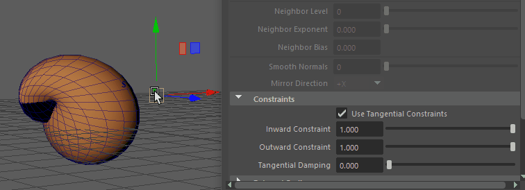

Constraints
Use the Tangential constraints to create a smooth slippery morph effect. See Create a sliding effect with the Morph Deformer.
- Inward/Outward Constraint
- The Inward Constraint and Outward Constraint attributes limit the vert motion over the deformed surface. The Inward Constraint stops the vertex moving beneath the surface, while the Outward Constraint stops the vertex moving outside the surface to preserve the current geometry contour.
- Tangential Damping
- The Tangential Damping slider lets you control the effect of the deformer drawing geometry back to its input deformed shape whenever there is a large difference between the Inward constraint and Outward Constraint settings.
