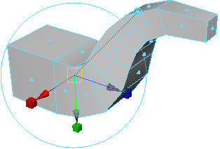

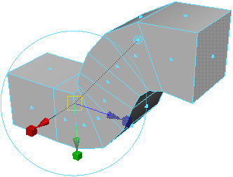

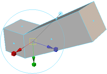

  5. Use the controls in the Attribute Editor or Channel Box to edit the extrusion.
    For example, increase Divisions so the extruded polygons better match the shape of the curve.

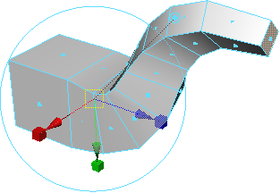

    Reduce Taper so the extruded polygons gradually become narrower along the curve. (You can also use the Taper Curve controls to create more complex tapers.)
    Adjust Twist so the extruded polygons rotate along the curve.
