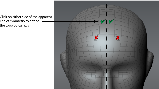

To set a topological axis
- Ensure the model is topologically symmetrical.
- Press Page Down until you display the base subdivision level (Level 0).
It is easier to select faces when the mesh is displayed at the lowest subdivision level.
- Select two adjacent faces, one on each side of the topological axis you want to define.
Tip: Press Shift + S to select single faces regardless of tool size. - Select Edit > Set Topological Axis.
