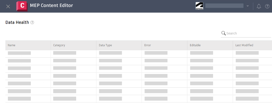

Data Health
When a fabrication configuration is uploaded to the cloud, the geometry and relationships within the content are validated. Data issues can occur when parts need to be upgraded or have invalid geometry.
Note: This option appears only when there is an issue with the configuration or data within the configuration and you are the Admin or Contributor for the configuration.
In MEP Content Editor, click Admin > Data Health.
For each entry in Data Health, the name, category, data type, error, whether or not it is editable, and the date modified is displayed.
Use the Relationship Manager to identify issues with data in the configuration. If you are the Admin or Contributor for the configuration, you can edit or delete certain items to resolve data issues.
