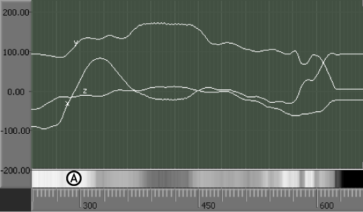

After creating a Rigid body, you can monitor its quality in the Optical editor.
To monitor Rigid body quality:
  1. Select Settings from the Optical Options pane.
  2. Click Show Rigid Body Quality.
    A. Rigid Body Quality option selected
    A bar appears at the bottom of the Optical editor indicating the quality of the selected Rigid body.
    Optical editor A. Quality bar
